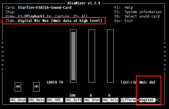

- 使能“dmic data” (高电平或低电平均可):
图 2. Dmic Data

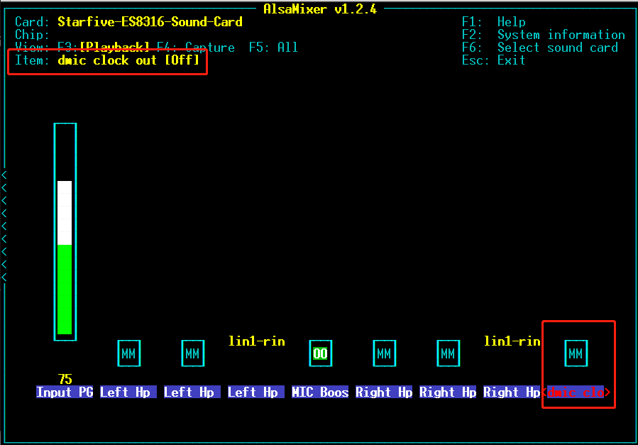

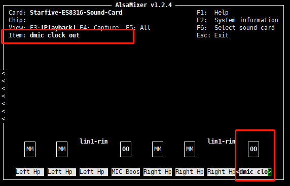

- 使能“dmic clock out”:
图 3. Dmic Clock Out

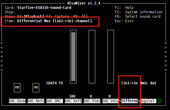

- 选择“Lin1-rin1 channel” (MIC1通道):
图 4. Lin1-rin1 Channel

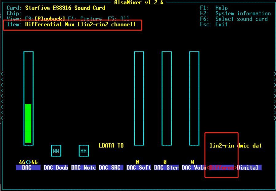

- 禁用“dmic clock out”(可选):
图 5. Dmic Clock Out
