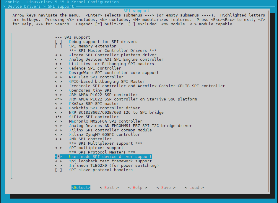

配置内核菜单
在内核菜单配置页面,请选择User mode SPI device driver support选项。
1. User mode SPI device driver support
